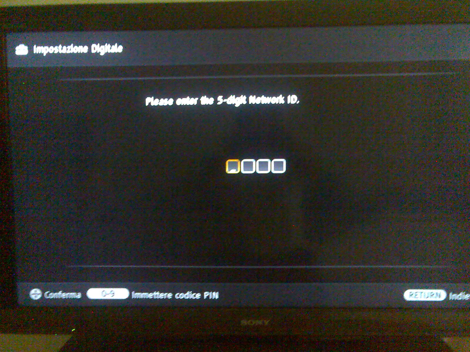

Hi all, first of all I cannot speak German but I joined to this forum because I really need information about Sony KDL-40Ex402.
I have this model and I bought CABLECOM Digicard. The model is not in the support list and I'm having problems in making it working.
Does anybody has a Sony KDL-40Ex402 working with CABLECOM Digicard?
Does anybody know if it work or not?
Thank you very much for your help.

domenico632 Beiträge
Hi domenico!You can try to update the Firmware: http://support.sony-europe.com/tvhc/tv/lcd/lcd.aspx?site=odw_de_CH&m=KDL-40EX402Hi all,
If it does not help, you should check your settings.
The ex402 works with the cablecom card, no worries, the guys here will help you /emoticons/default_wink.png
Vielleicht kann ein Sony Besitzer kleine Tipps geben?!
I already updated the firmware.
The problem is that when I insert the cam atfer an "Authentication process" few seconds screen the TV ask me to enter the Network ID but I have only 4 squares to enter the ID.
So I cannot enter the correct Network ID.
Here attached the screenshot.
I contacted also CABLECOM but the didn't manage it. From Sony no answers.
Thanks.

Dubai-Fan2'002 Beiträge
i guess this are only the sony menue PIN-Code fields to enter the CI-Menue, as you see at the bottom of the screen. as soon as you enter the PIN-Code like 1234 or 0000, you will have access to the full CI-Menue for to enter the setup-ID and all the other necessary stuff you got from CC and you have to type in.
bearbeitet #260
Hi all,I already updated the firmware.i guess this are only the sony menue PIN-Code fields from the tv itself, to enter the CI-Menue, as you see at the bottom of the screen and why you have only 4 squares. as soon as you enter the PIN-Code like 1234 or 0000, you will have access to the full CI-Menue to enter the setup-ID and all the other necessary stuff you got from CC with your digicard and you have to type in.
Thanks.
defaullt PIN-Code you should find in the sony manual, if none of the above. EX402 is CI+ ready, as i have read in the technical specifications.
